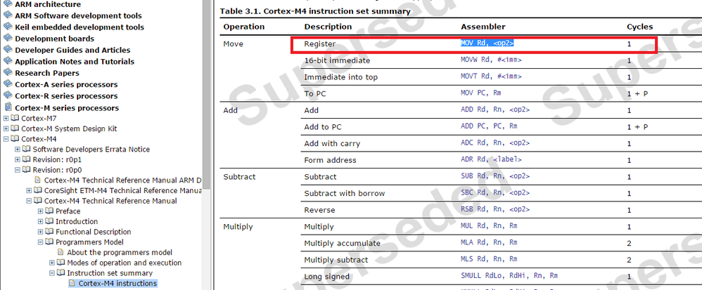

According to the ARM website the CORTEX-M4 assembly instruction
MOV Rd, <op2>
takes one cycle to be executed. That’s mean this instruction is executed in 5.95ns??? is that correct ??
