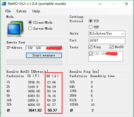

CubeMX4.25 + STM32H743 + LwIP2.03
2018-03-23 5:38 AM
The first thing is to find what's limiting the speed ...
2018-03-23 6:45 AM
Profiling the code, and instrumenting the IRQ handler might provide insight.
I'd presume there is a lot of serialized mentality in the examples. Look for examples using threaded execution and that can handle a lot of inflight packets efficiently.
You might also try other stacks.
Note that 192.168.xxx.xxx addresses are LOCAL, millions of people use these same address ranges in there local networks and on routers, they aren't secret or accessible from the greater internet.
