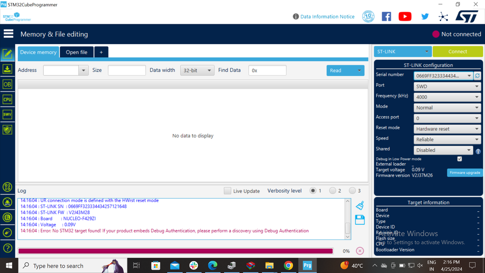

Try with CubeProgrammer , set mode "under reset" , reset "hardware reset" , connect ;
then show , what it tells (screenshot).
2024-04-25 1:45 AM
2024-04-25 2:15 AM
see:
So your board -> F429 cpu has no power. Check jumper settings, see board manual.
Then connect again....
