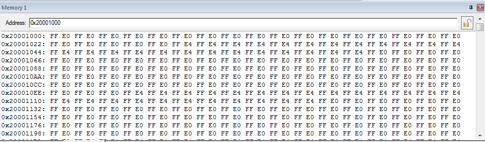

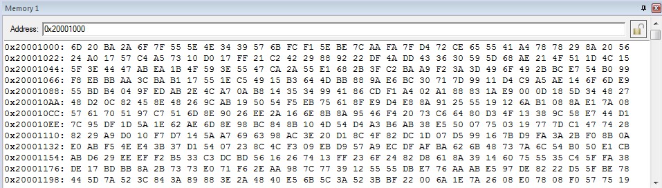

So, here's some screen shots:
SOME_ARRAY after power off then on.
SOME_ARRAY after DMA interrupts program flow (without WFI).

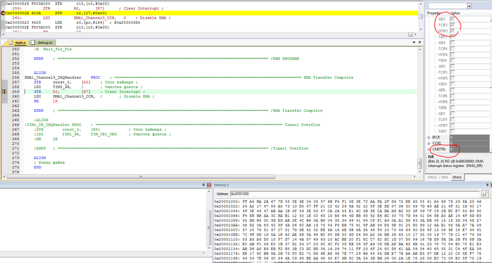

SOME_ARRAY after DMA interrupts program flow (with WFI)
All flags are set (GIF, TCIF, HTIF), data counter is zero. But there's no data in SOME_ARRAY.

Isn't it suspicious that the DMA control register is all zero?
