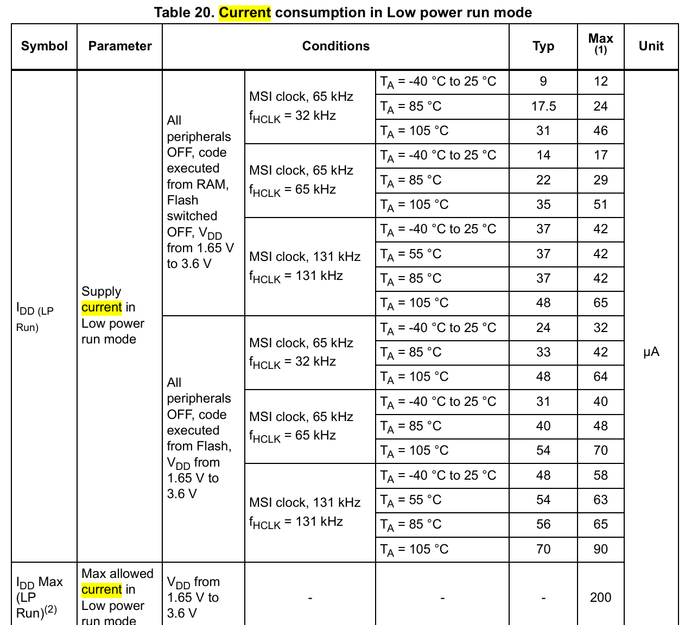

2025-01-24 10:34 AM
You some miss. Real MCU current can be very low as you see in table
and combined with STOP under 600nA.
