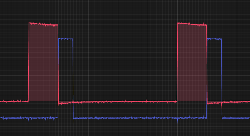

}As a result it seems they synchronized as desired (Red channel is TIM2 and blue channel is TIM5):

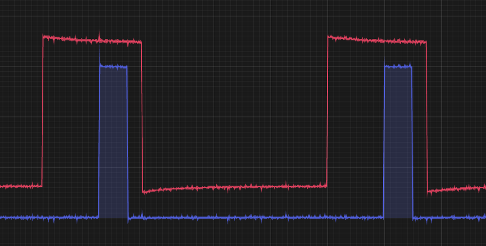

}This button function can disenable, restart TIM2 or increase the duty cycle. But TIM5 does not follow this configuration and synchronization breaks down. I've tried to toggle CEN bit of TIM5 and reset the CNT register but as shown below TIM5 does not follow the master.

You don't need to stop TIM2 when changing duty cycle. However, you may want to enable CCRx preload by setting TIM2_CCMRx.OCxPE.
If you want to disable TIM2, you have to manually disable TIM5, too. To start again, it's then enough to enable the master (TIM2).
An intereting alternative might be to set TIM5 to One-Pulse Mode (by setting TIM5_CR1.OPM).
