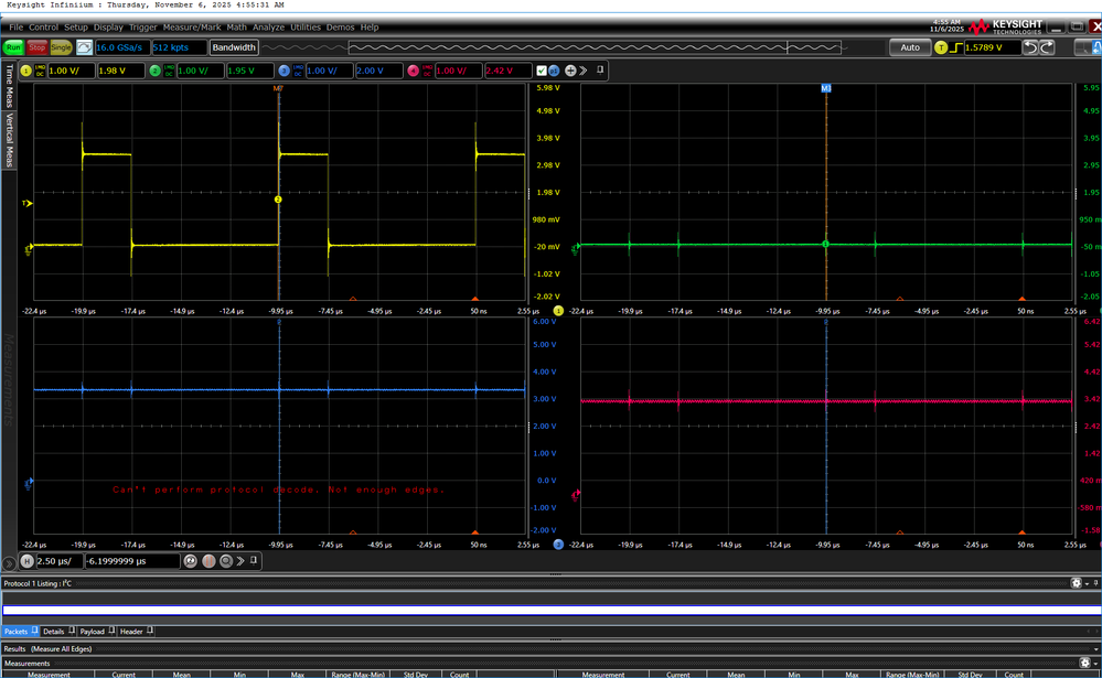

The problem I am having is with PA1. I am not getting a signal.
Channel 1 (Yellow) is PA0 and Channel 2 (Green) is PA1.
Does anyone have any suggestions on how to get PA1 working?

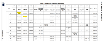

Hello @allanoverst
I think there is some confusion regarding the alternate function assignments for PA0 and PA1.
Your code should be like below:
void MX_PWM_GPIO_Init(void)
/* Enable clocks */
__HAL_RCC_TIM2_CLK_ENABLE();
__HAL_RCC_GPIOA_CLK_ENABLE();
/* Configure PA0 for TIM2_CH1 */
GPIO_InitStruct.Pin = GPIO_PIN_0;
GPIO_InitStruct.Speed = GPIO_SPEED_FREQ_HIGH;
GPIO_InitStruct.Alternate = GPIO_AF1_TIM2; //CH1
/* Enable clocks */
__HAL_RCC_TIM5_CLK_ENABLE();
/* Configure PA1 for TIM5_CH2
* NOTE: Using CH2 on PA1 to avoid conflict with TIM2_CH1 on PA0
* You can use different pins if needed
GPIO_InitStruct.Pin = GPIO_PIN_1;
GPIO_InitStruct.Alternate = GPIO_AF2_TIM5; //CH2
HAL_Delay(10);
