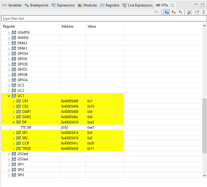

I have an STM32F411RE Nucleoboard and an ADXL345-M accelerometer. I have 2 problems.
I attach my code and a picture about register values.
Thank you in advance for your help!

> uint8_t id[0];
"id" is defined as array of length 0. Probably not going to be able to put anything in there. Technically array of constant length 0 aren't allowed, but GCC didn't throw any warnings for me on it with default settings.
I2C protocol requires you to react to certain events quickly enough such that single stepping in the debugger is likely to cause problems. I would suggest finding another method to debug, perhaps through a UART stream or ITM.
The value that you store in "id" is also never used anywhere, so the compiler is free to optimize that out.

Thank you for the answer!:folded_hands:
Indeed the 0 array length was the problem...This is the case when can't see the forest for the trees.=)
