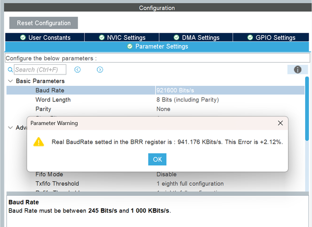

Depending on your clock speed, setting for 921600 doesn't mean it's exactly 921600. If you play with the clock especially with a high baud rate, sometimes CubeMX/STM32CubeIDE will give a warning that there is an error greater than some %.
There could still be a slight % error, but CubeMX may not give a warning if it's under a threshold? I'm just assuming about the threshold, so take that with a grain of salt.
Since you're using TeraTerm, i assume you're using some USB-Serial adapter. That adapter too, could have a % error.
Maybe check with a scope to see if indeed both devices are exactly 921600?
Why CubeMX should be concerned? 1Mbit/s is not a terribly high rate for UART (maybe 2.5 Mbit/s is marginal) but can work with proper connections. CubeMX is not responsible for this. For higher bitrates better ways exist, based on LVDS and similar. Reasonable data corruptions can be worked around by software. (sorry, can't give any ready code to copy-paste).

The higher the rate, the less well it will divide into the Peripheral Clock, but it's not a cumulative error, on the Rx side it should be resyncing/framing based on the bit centers.

I didnt get an % error considering my configuration, i think the problem that the my Programm dosent handle the data properly while the communication baudrate is too fast and the data is big
