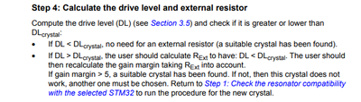

Rext is required only if If DL > DLcrystal.
Please refer to the application note AN2867 "Guidelines for oscillator design on STM8AF/AL/S and STM32 MCUs/MPUs":
Please also refer to the section 3.5 Drive level and external resistor calculation in the same application note
Hope that helps.

You need at least to measure VPP with an oscilloscope, otherwise you cannot continue:
I do not have a 0.1pF probe to make an accurate measurement, I can attempt to but I believe a standard probe will affect the measurement as it will greatly impact the load capacitance.
The probe should not exceed 1pF of capacitance not 0.1pF:
Ok in the note it indicates it should not exceed 0.1pF (for the voltage measurement)
I need to escalate that internally for the verification (for the current measurement)
