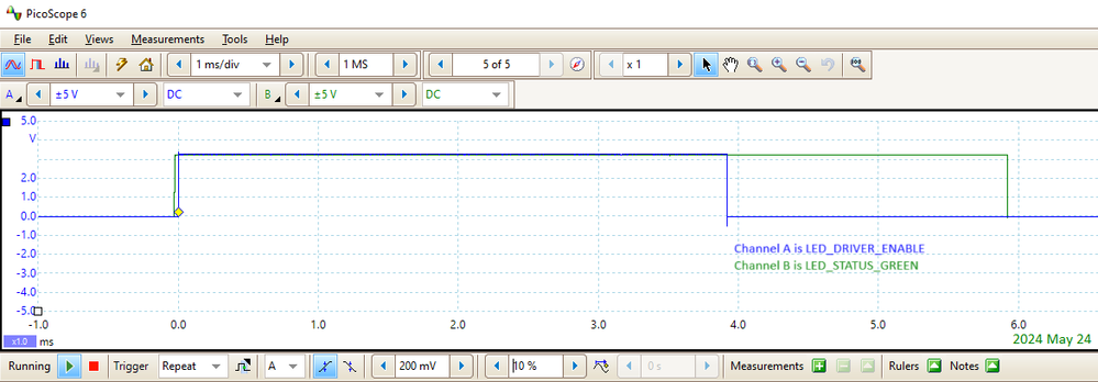

The resulting picture on the oscilloscope looks quite wrong.
oscilloscope screenshot of GPIO outputs
Legend for the oscilloscope plot:
Channel A is LED_DRIVER_ENABLE (PA3)
Channel B is LED_STATUS_GREEN (PB0)
The most troubling part is that the LED_STATUS_GREEN goes up before LED_DIVER_ENABLE on the oscilloscope. In the code LED_DIVER_ENABLE precedes LED_STATUS_GREEN. [It's more visible in my update below.]
In addition, the first call to HAL_Delay(1) produced a 0.1ms delay instead of expected 1ms. The second and third calls to HAL_Delay(1) produced 4ms and 2ms delays.
What could be causing these issues?

(you know of course that HAL_Delay(1) can take any time from 1 to 2 ms ? )

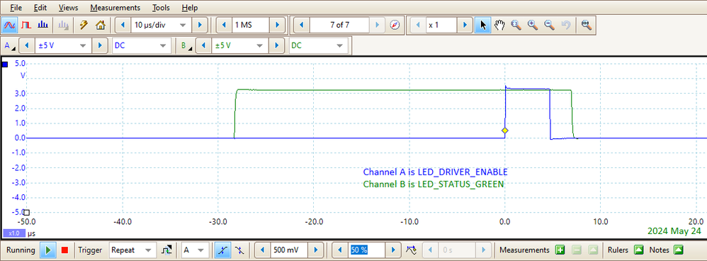

Here's an even more condensed code for this issue. I removed the delays, but the GPIO outputs are still out of order.
HAL_GPIO_WritePin(LED_DRIVER_ENABLE_GPIO_Port, LED_DRIVER_ENABLE_Pin, GPIO_PIN_SET);
HAL_GPIO_WritePin(LED_STATUS_GREEN_GPIO_Port, LED_STATUS_GREEN_Pin, GPIO_PIN_SET);
HAL_GPIO_WritePin(LED_DRIVER_ENABLE_GPIO_Port, LED_DRIVER_ENABLE_Pin, GPIO_PIN_RESET);
HAL_GPIO_WritePin(LED_STATUS_GREEN_GPIO_Port, LED_STATUS_GREEN_Pin, GPIO_PIN_RESET);
Channel A is LED_DRIVER_ENABLE (pin PA3)
Channel B is LED_STATUS_GREEN (pin PB0)
time axis in [microseconds]

As @Pavel A. said above, a minimum-1ms-time-wasting-delay with 1ms granularity can take 2ms, and it does, if it is invoked two times in a row.
My guess is that you set LED_STATUS_GREEN in the code you haven't shown us, before the snippet you've shown us.
Place a breakpoint - or infinite loop - just before that code and observe LED_STATUS_GREEN.
2024-05-26 2:04 AM
Make sure to set the scope to CHOP mode (not ALT).
