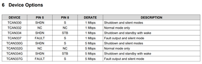

Ok but D suffix was not listed in their table:
Enable the delay compensation but the most important thing is to use a transceiver that can reach 8Mb/s.
And it worked at 2Mb/s because the chip manufacturer has a margin and that could not work for all the conditions.

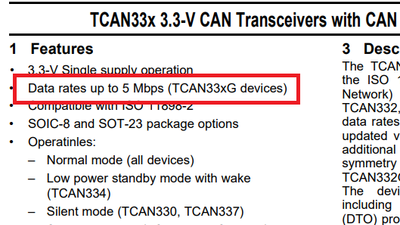

No, the TCAN334D datasheet says that it could reach 5Mb/s:
So that's normal you didn't get it worked at 8Mb/s but worked at 2Mb/s.
Replace the transceiver: example: MCP2561FD or MCP2562FD to reach 8Mb/s.

2024-11-21 5:34 AM
Thanks for your answer.
The speed up to 5Mbps is written for TCAN33..G series, I am using the D series. so it may not support 5Mbps speed..

2024-11-21 5:47 AM - edited 2024-11-21 5:47 AM
