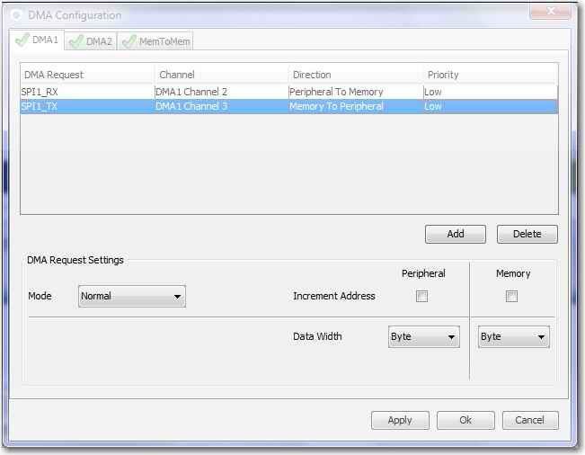

To configure DMA, you can use CubeMx as you have indicated. Just make sure that in the configuration view, within SPI parameter settings, you set desired DMA Settings (click Add button-Select the DMA Request- and set all other seetings). So, the generated project will contain DMA configuration. Besides, you can refer to examples using DMA within STM32Cube firmware package. -Shahrzad-2015-10-01 7:18 AM
Is my configuration correct ? thanks
