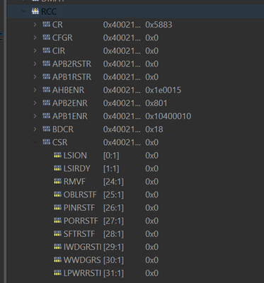

I added a breakpoint at line 4 and stepped over to complete the read. This is what the registers look like after IWDG resets the MCU:
Note that LSION and LSIRDY aren't set because I am stopping before IWDG is initialized again.

Something may be clearing those flags. One bit at least should always be set. Can you zip up your project and attach? You can set a breakpoint at Reset_Handler to catch it when it just resets.

Given non-reset-default AHBENR/APBxENR (enabled DMA, TIM1, I2C1, TIM6) I bet you have some custom bootloader running before the application.

You are absolutely right. I completely overlooked my bootloader. I will look into that.
