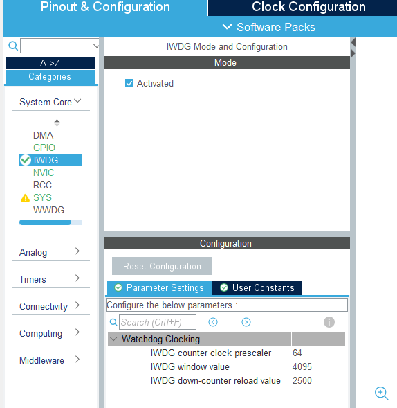

}Also what is the purpose of IWDG window value here?

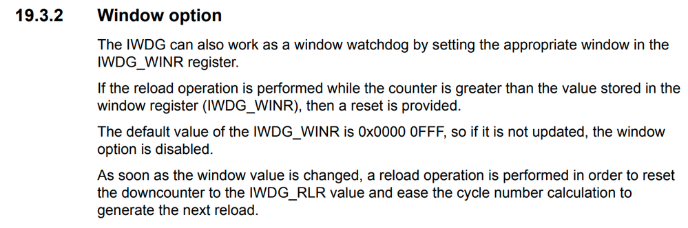

The reference manual covers the functionality of the window field. It is used when you want to ensure reloads of the IWDG are done periodically. At its max value of 4095, it is effectively disabled.

}Does it required to call the IWDG is prior to start read the data from flash? As it need to read 2KB of data from flash is it cosuming more time? Also IWDG init itself calling after the read completed from the flash, are there any default WDG setting sone even prior to init IWDG? As per the my configuration values I'm asssuming the IWDG reload interval is 5S, is that correct?
