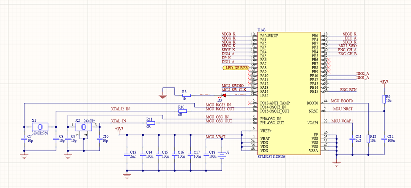

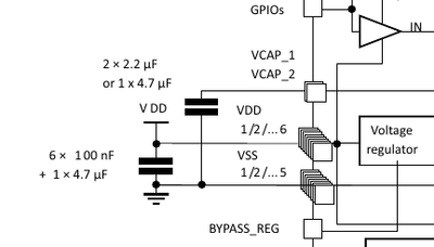

2024-03-30 2:09 PM
VCAP should be 4,7u.

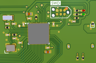

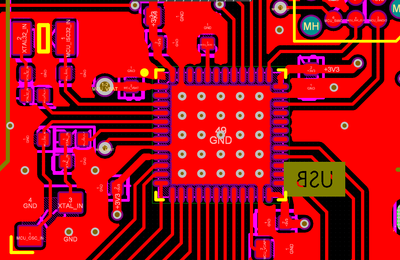

Dear @DerekSavage ,
May be I overlooked the GitHub files , can you please share the schematics and PCB , in particular power pins / VCAP and associated capacitors and crystal datasheet : 32KHz. I see the system clock is set to PLL using HSI and not HSE .

2024-03-30 2:01 PM
I was able to get home early.
It won't let me upload .SchDoc files so I hope these screenshots will suffice:
2024-03-30 2:09 PM
2024-03-30 2:23 PM
I have one somewhere, let me find it and solder it on.

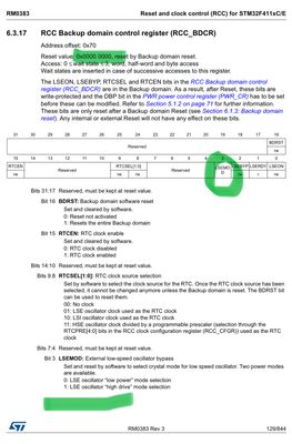

2024-03-30 2:50 PM
Another useful feature also to activate at startup before LSE is on the High drive mode to check , after reset it is set to low drive . To suspect any stability issue with your selected crystal and the 0 ohm resistor that is not necessary and I saw in other designs as source of issue .
Our goal is to eliminate any Hardware issue before going to software . Good debug !
