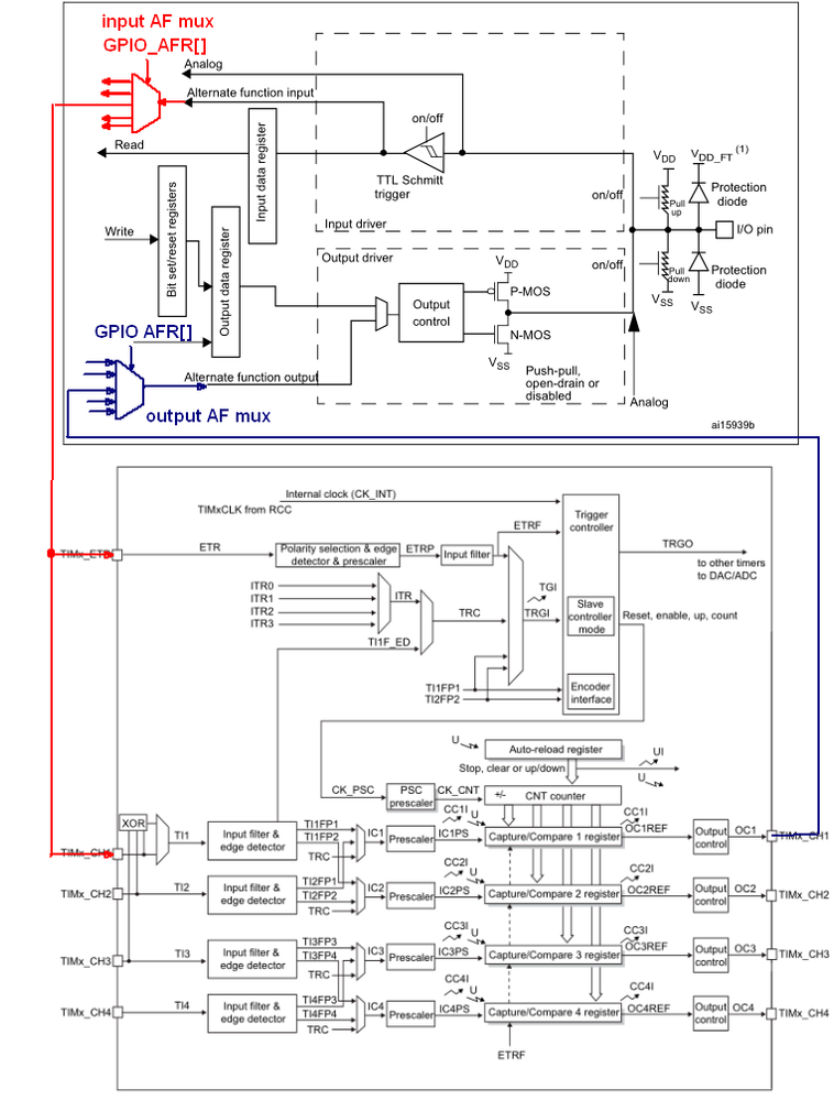

For some reason the picture you [Sara] posted is not showing up, but I can access it from email.
I am not sure what you are trying to tell me. That picture (if I understand) says a timer can have 5 pins: _CH1, _CH2, _CH3, _CH4, _ETR. The _CHx can be either input or output. Nothing is listed as _CHx_ETR as mentioned in the documentation.

It means just this: the CH1-input and ETR pads of the internal TIM module are simply hard-wired together (and then connected to output of the input AF MUX in GPIO).
In other words, you are not supposed to use both CH1 and ETR at the same time in TIM2; if you do, everything works as expected, but the results may be confusing, as signals simply come in both ways.
Or, in even other words, if you don't enable any ETR functionality (i.e. external clock from ETR or the output clear from ETR, see ETR subchapter of TIM chapter), you can use those pins simply as TIM2_CH1.
Yes, the pin marking is confusing. And, ST can't decide, whether to mark it TIM2_CH1/TIM2_ETR or TIM2_CH1_ETR - both mean the same. Both are confusing and ST switched back and forth (in various versions of this DS and DS of other STM32 which have similarly merged functions on pins) so long that both of them are present in the current DS, increasing confusion. Yes, ST are not famous for being meticulous. And they are also not famous for their ability to explain things in simple terms, as they for some inexplicable reason (or is it a valid reason? are the mcu programmers scared of hardware/electronics?) prefer confusing shorthands and muddy expressions to conventional engineering block diagrams and schematics.
