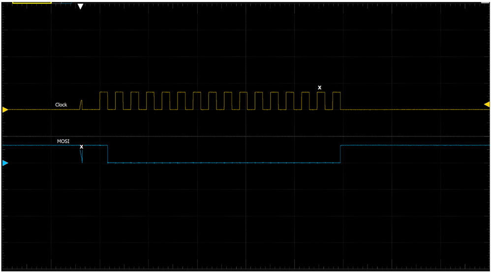

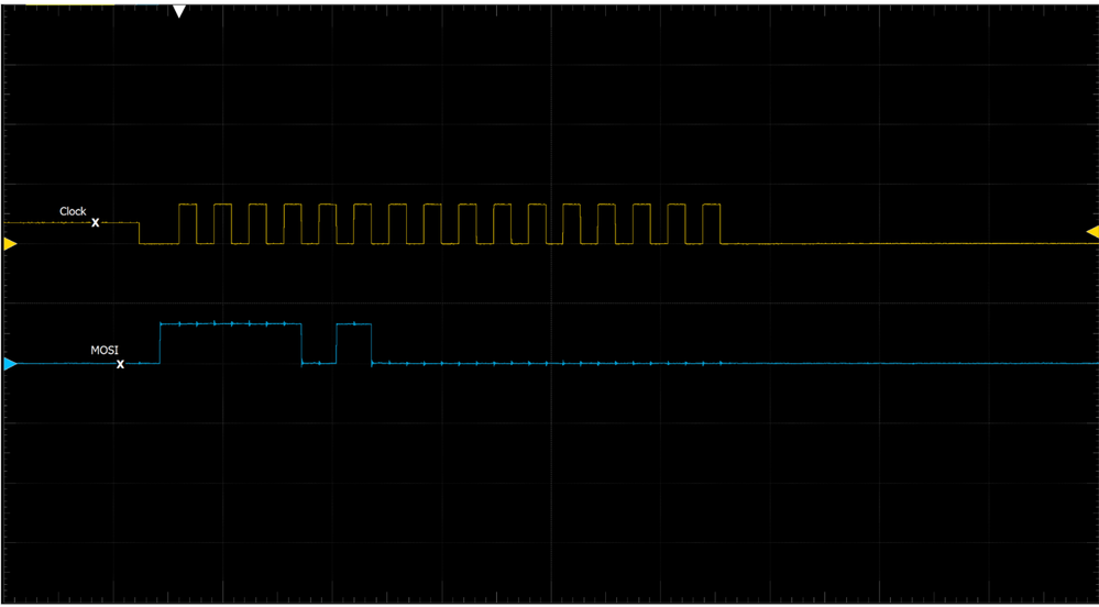

I am learning to write driver code for SPI. I have an nucleo-L476RG development board with me implementing full-duplex transmit only operation and reading the output of a MOSI pin using a logic-analyzer. The Nucleo board is working as the master

Case: 1 Data transferred: 0x1
Case :2 Data Transferred : 0x2F, Data Size(DS= 4)

1+2) Show the actual code. You may be sending more data than you think due to data packing.
3) You can see max frequency of pins vs speed setting in the datasheet. If it's working, it's probably fine.
4) Writing 3x 8-bit values to DR in 2-line mode will produce 24 clocks.

Thank you for your inputs, based on it I found that the controller was writing 16bit to the SPI1->DR register. Earlier I had implemented it as
//8 bit transfer ,pTxBuffer = pointer to uint8_t
pSPIx->SPI_DR = *pTxBuffer; Now It works when after typecast now the code looks like
*((uint8_t*)&pSPIx->SPI_DR) = *pTxBuffer;Now the logic analyzer send out 8 bit when the data size is configured as 8 bits
@Community member If you are still figuring out why 16 clocks are sent out when the data size is set as 8 bit, this might be a possible solution
