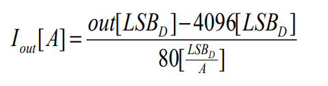

Thank you all. I have to use this formula to calculate the current. I don't need much precision.
Relatively small numbers, would be fine.
Where you'll run into trouble is you've got a number like 2 billion, and want represent/differentiate 2B+1 and 2B-1
