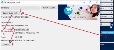

As said by @Andrew Neil , you can disable it by changing type but you can do it with CubeProgrammer:
Click "Firmware upgrade button" Then click "Open in update mode" button. Check the box "Change type" , finally select "STM32 Debug+VCP" and click "Update":

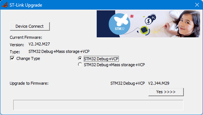

Turns out there is a way to disable the mass storage feature of the ST-Links on Nucleo boards:
it uses the ST-Link Updater, STSW-LINK007: https://www.st.com/en/development-tools/stsw-link007.html
That gives you the option to change the 'Type' from 'Debug + Mass Storage + VCP' to just 'Debug + VCP'
