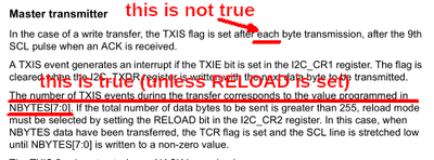

In the datasheet there is this line: "In the case of a write transfer, the TXIS flag is set after each byte transmission, after the 9th SCL pulse when an ACK is received", but for the last byte TXIS remain LOW and TC become HIGH.
It's correct that for the last byte that I have to send via I2C, the TXIS bit remain LOW?

OK I think I understand what is the source of your confusion. I believe the flowchart is not quite correct. We might've discussed this here before, I can't find that thread at the moment.
> 1) Sometimes at the end of the transmission, the TC bit remain low but I notices that if I put some delay before the TC check it work(as if I had to wait a certain time first, but in the flowchat I don't see this)
After storing the last byte to TXDR, it takes time until it gets transmitted. Only after the last byte gets transmitted is TC set.
> 2) It's correct that for the last byte TXIS remain low?
Yes. Again, the narrative and the flowchart is not quite correct. The intention is, that TXIS is not indicator of "transmit register got empty" but "transmit register needs data"; the distinction is exactly that after the NBYTE bytes have been transmitted, there is no more "transmit register needs data" request.
