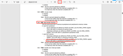

I think your understanding is correct, that is, 'P' in register name is not restricted to the 'Peripheral device' and 'M' in register name is not restricted to the 'Memory device'.
Page 208 of the STM32F0x1 reference manual also emphasis this, as showed below:
