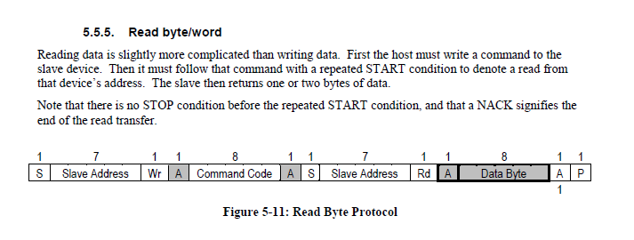

When I run this code, The oscilloscope shows the device address is detected and the acknowledge from the Bq40z80 but it doesnot show the command code being transmitted. I have attached the image from oscilloscope. I have also attached the screenshot for reading a word from SMBUS specification manual.
Could anyone help me regarding how can I read one of the battery parameter using HAL_SMBUS_Transmit_IT() and HAL_SMBUS_Receive_IT() functions.
