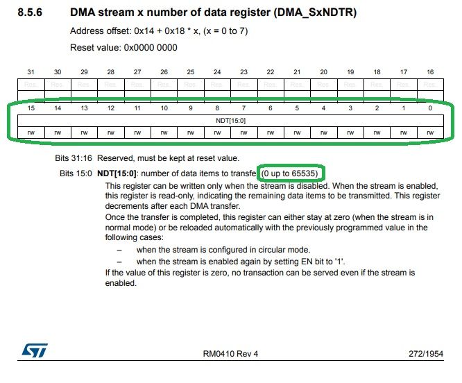

There is not a 64kB limit to the QSPI address space and the chip on there has much more than 64kB of capacity.
Debug the code, where does it hang? Be specific.
2021-08-02 4:15 PM
DMA might have a 16-bit limit on the transfer count.
Many of the current QSPI NOR Flash have a 64KB block size. Usually a 256-byte page alignment/limit.

Okay. And where is your HAL_QSPI_Receive_DMA call? Are you trying to read more than 65535 bytes at a time?
2021-08-05 8:40 AM
Yes, if I try to read more than 65535 then I will never get the RxCplt flag set meaning the code waits indefinitely for the flag to be set.

Doesn't the DMA unit have a 16-bit transfer count limit?
For byte transfers that would be 64KB (perhaps less one byte)
Use HALF WORD or WORD transfers for larger transactions, and make sure your buffers are suitably aligned or decompose the transfers until they can be.
2021-08-05 9:45 AM
2021-08-05 10:03 PM
Thank you for your help, sorry I should have checked the reference manual closer, this explains things I will check this out.
