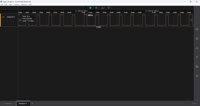

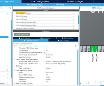

Going with the very basic PWM generation on both lines "PC8" and "PB0", Im hereby providing more details of the configuration i made. I configured PB0 for TIM3_CH3 for PWM with the below settings and called APIs HAL_TIM_Base_Init(htim) and HAL_TIM_PWM_Start(htim, Channel). The settings successfully generated PWM on the line PB0 as observed on the salae capture.
Exactly the same settings made for the pin "PC8" which is also an AF of TIM3_CH3 (Ref: STM32H753xI datasheet Table 8), There is no PWM signal observed on the line. Hence, I seek more clarity on why such difference when datasheet claims that both PC8 and PB0 can be configured for TIM3_CH3.
