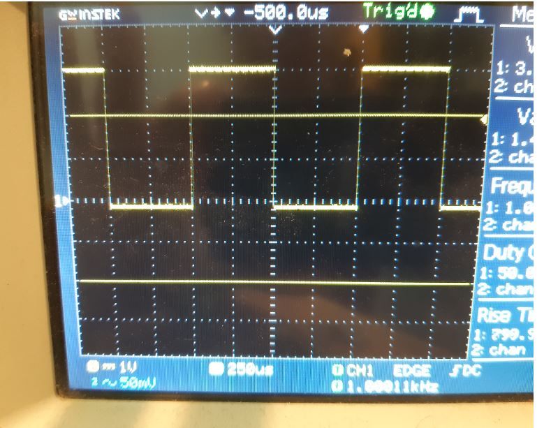

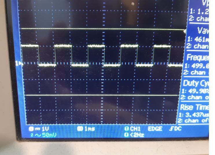

I changed my program to
void TIM4_IRQHandler(){
if(X!=1){
X=1;
GPIO_SetBits(GPIOE,GPIO_Pin_13);
}else
X=0;
GPIO_ResetBits(GPIOE,GPIO_Pin_13);
TIM_ClearITPendingBit(TIM4, TIM_IT_Update);
//TIM_Cmd(TIM4, ENABLE);
}and Here is my output:
and Here is my PWM output
They are the same( my PWM takes 1ms to make a Pulse , and my IRQ Toggle the output at 1ms,Am I right?) my variable is long volatile but it takes the wrong value.
