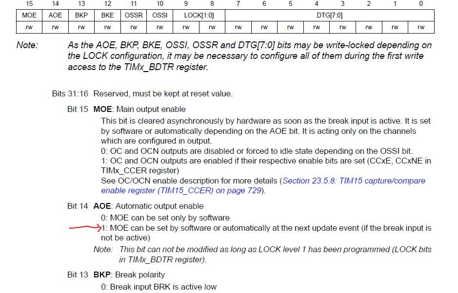

By setting the AOE bit in BDTR reg , forces output to enabled state in the next update event

That makes sense, but I guess my next question for you is shouldn't the MOE bit be set by default or set in the generated STM32CubeMX code in the event that both break inputs are disabled? This confused me for a little while since I got the PWM output generation working on TIM3, but now I realize that TIM doesn't have a BDTR register.
It's enabled within HAL_TIM_PWM_Start. You chose LL, so the system expects you to be fluent at the register level with what is needed to enable outputs.
