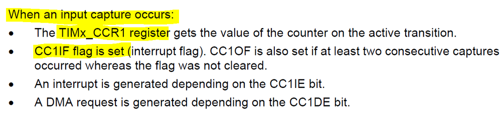

According to the manual it says:
When a capture occurs, the corresponding CCXIF flag (TIMx_SR register) is set and an interrupt or a DMA request can be sent if they are enabled. If a capture occurs while the CCxIF flag was already high, then the over-capture flag CCxOF (TIMx_SR register) is set. CCxIF can be cleared by software by writing it to ‘0’ or by reading the captured data stored in the TIMx_CCRx register. CCxOF is cleared when written with ‘0’.
In theory, I could check cyclically against that flag inside the register and decide whether captures are availabe or not?!?

CCRx registers are updated when there is an event. So if you remove the source, no event, they are not updated or changed. You can use the CCxIF flags to know when they have been updated.

What is your assumption in your explaination? Interrupt enabled or not ? In my case, I would like to not use any interrupt overhead for PWM input measurement as I can easily read CCR1 for the period and CCR2 for the width.
So the statement written in the manual as well as your statement that the CCxIF flag is just set after each consecutive successful input capture is still valid? Or do I need to enable interrupt ?
2022-01-27 1:02 PM
I made no assumptions about interrupts being enabled or not. CCxIF is set even if CCxIE isn't set.

thanks for the feedback, this is exaactly what I wanted. I tested this approach with minimal SW overhead when taking the flags into account and I am able to reset the frequency parameter to 0 in a simple and determinisitc fashion.
