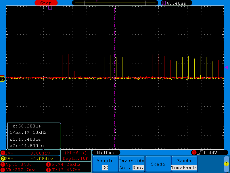

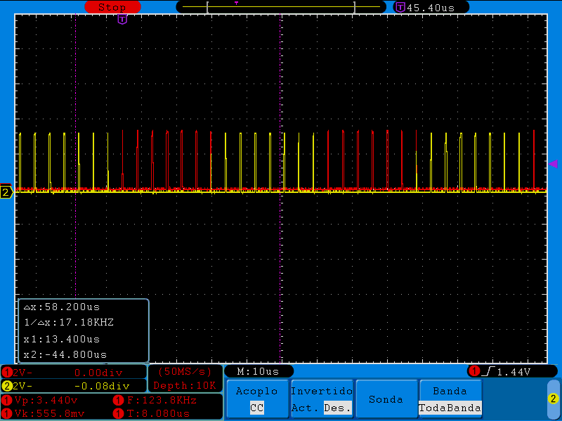

Hi, I'm using the PWM to create a sinusoid at a desired frequency and amplitude.
I have a table with the values, and I am updating it during the execution of the program. But I have an unexpected glitch that overlaps with the other modulation, and that would make me drive both transistors at the same time ... a total ruin in my application. Where does this glitch come from? I put some captures and my code:Modulation without glitch:
After a while, the yellow glitch appears in the left:

#pwm #stm-32 #pwmoutput #stm32f1032017-02-14 1:53 PM
tim3A[6]=timreal[0];
//tim3B[6]=0;
tim3B[6]=timreal[0];
Isn't this the overlap? Shouldn't tim3B values be shifted by one index?
2017-02-15 2:39 AM
Hello
Waclawek.Jan
, Yes, I've been doing some tests, but putting it well, that glitch still appears. The table has 7 nonzero values, however, I have 8 pulses. Do you know why this glitch can be produced?We’re moving the ST Community to a new platform to give you a better and more reliable community experience.
