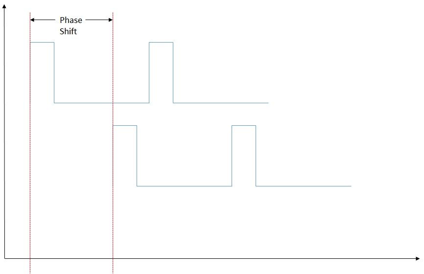

I am using TIM3 with 4 channels to generate a PWM signal for my motors. Right now there is no phase difference between the PWMs, but now there is a requirement where I need to generate a Phase difference like shown in the figure below

Use two timers in master-slave configuration. In Master, set up a different channel than the one outputting the "nonshifted" wafevorm, CCRx of that channel will then determine the phase shift. Set the slave's slave-mode controller to "reset" mode, and let it generate the same waveform.
In newer STM32's timers there's a Combined mode allowing to generate a shifted waveform by combining two channels within one timer, but AFAIK that's not available in the 'F0.
For a limited range of delays, a trick using deadtime is possible in Advanced timers such as TIM1, https://community.st.com/s/question/0D50X0000ADEhGUSQ1/using-tim1-for-get-two-positive-pulses

Apart from the thread linked by @Community member using TIM1 dead time, it's possible to control GPIO outputs with DMA transfers triggered by timer channels.
If there are only two channels as depicted in the question, the following should work (provided there are free DMA channels)
If there are more channels, see a more general solution here. This unfortunately needs some more RAM to work properly, to hold the bit pattern buffer. If the hardware is not finalized, consider switching to the STM32G0 series, which has more memory for the same price.
Depending on the frequency and jitter tolerance constraints, you might get away with doing all this in software timer interrupts, whithout using DMA at all.
