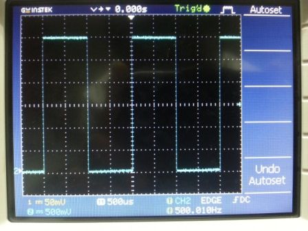

Hello everybody.
I am trying to generate a 5 PWM signals and all should look like the one below when the duty cycle is set to 50%. 4 of the signals should be generated on TIM 5 (CH1, CH2, CH3, CH4) on pins A0, A1, A2 and A3. The other one should be generated on TIM 9 (CH1) on pin E5I am having trouble with properly understanding how to set the prescalar and period to get this pwm signal.2014-03-27 10:10 AM

The system clocks weren't configured properly.
Thanks cliveWe’re moving the ST Community to a new platform to give you a better and more reliable community experience.
