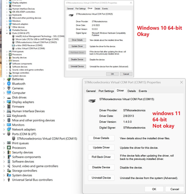

I have a mLRS MAVLink 900MHz TX Module KIT, mR900-30-TX, and successfully converted it to use it with mR24-30 as a TX in SiKTelem mode: tx-matek-mr900-30-g431kb-siktelem-xxx. It works well under Windows 10 64-bit with STM32 COM PORT DRIVER 5.0.0.0 but it fails to work with Windows 11 64-bit STM32 COM PORT DRIVER version 1.4.0.0.
How do I get it working under Windows 11 64-bit? I have tried this driver and it does not support Windows 11.
