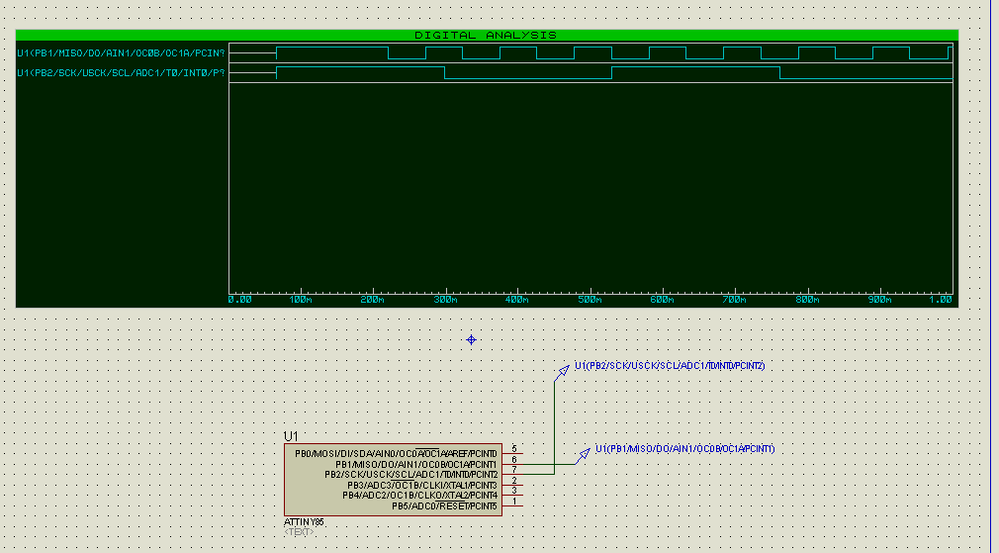

I tested this on an ATtiny85, TIMER1. Output compare channel A is configured to have a period of 200 ticks (each = 256 * 1024 * 1/2Mhz), and a duty cycle of 100 ticks.
Output compare channel B is configured to generate user specified delay. 450 ticks in this case.
Timer1 output compare ch b ISR:
//tmr1 output compare ch b isr
ISR(TIMER1_COMPB_vect) { //clear the flag - done automatically if (tmr1b_ticks == 0) { //time has run out TIMSK &=~(1<<OCIE1B); //0->disable interrupt, 1->enable interrupt //optionally, run a quick user routine here //IO_FLP(OUT_PORT, OUT_PIN); //flip out_pin } else { //more time to go tmr1b_ticks-= OCR1C; //decrement tmr1b_ticks //do nothing here }}the main code:
pwm1_init(TMR1_PS1024x); //initialize pwm1. top at 200
pwm1a_setdc(100); //duty cycle on timer1 ch aIO_OUT(OUT_DDR, OUT_PIN); //out_pin as output
ei(); //enable the interrupt while(1) {if (tmr1b_ovf()) { //if time is up, restart the delay tmr1b_start(OUT_TICKS); //re-start the delay IO_FLP(OUT_PORT, OUT_PIN); //flip the output pin }}here is the output, as expected.
Now, the mcu is different but the basic approach applies to stm32/8 (or any other mcu) as well. So what was considered ''impossible'' is actually very easy to execute.
hope it helps.
