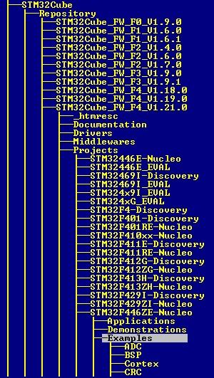

2018-07-08 9:53 AM
The HAL is provided with complete source code, and the code trees contain dozens of examples and demo applications, for dozens of boards.
Use a file manager, or static analysis tool of your own preference to navigates the available resources, find examples that closely match your goals and port to the target platform.
2018-07-08 10:08 AM
Do these sources get installed in accompany with the CubeMX? I can not find them in the installation path.
