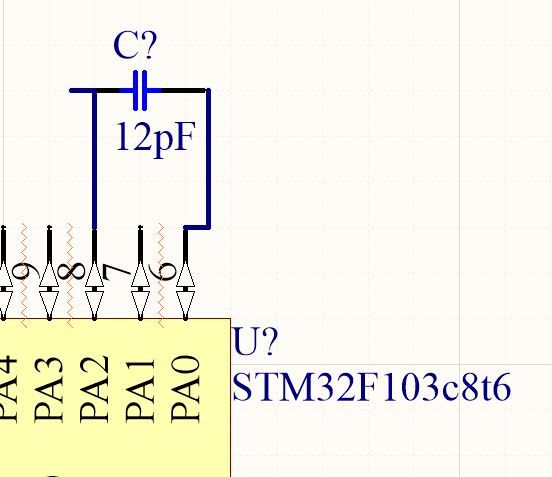

think about the ADC as a high impedance input.
If the capacitor is connected only to the ADC and your GPIO, your cap is not charging/discharging, youre not closing the cricuit.
Could you show us a schematic/drawing or picture of your setup?

2022-08-01 9:02 AM
here is my schematics
it is quit simple, I wired up the very same circuit on Arduino and it worked just fine. that's why I think the setup is OK but how can I discharge the 12pF correctly?

Seems you name function OUTPUT but config pin as INPUT usw.
Your code do what you write. PA2 go HIGH and if is configured as drived OUTPUT then C is Xc and transfer pulse to ADC = 1,7V
2022-08-01 10:53 PM
yes, sorry bad name choosing but in last attempts I tried to make the pin INPUT to pull it down to GND in order to discharge the 12pF cap.
shouldnt C just be discharged using pull down resistor which is ~40K ohm as mentioned in datasheet?
