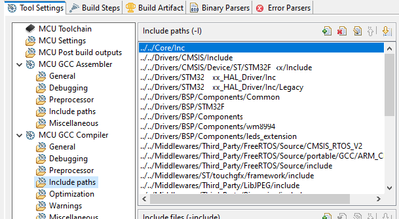

For includes, they are already seen in .c files. You don't need to add it manually by drag and drop. All you need is to add the include path here:
Example:
Example:

I didnt knew I can include path content for header's file with gcc -I in stm32cubeIDE.
That's what I was looking for !
