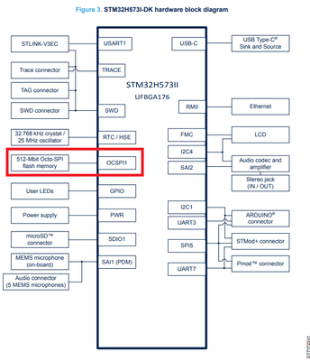

2024-07-08 6:37 AM
but STM Discovery Kits dont seem to support such high flash & RAMs. An FPU would be also nice to have feature.
Just to mention that There is an 512-Mbit Octo-SPI flash memory on the board:
But unfortunately no high SRAM size on the board.
