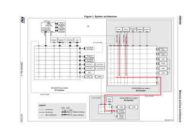

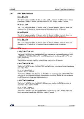

Looking at RM0468, 2.1 System Architecture "Table 2. Bus-master-to-bus-slave interconnect" shows that DMA1 and DMA2 have access to basically everything except TCM, including APB4 peripherals and SRAM4.
Is there some hidden feature to let DMA1 / DMA2 actually access "D3 domain"? If yes, how?
Am I reading that wrong, or is it another documentation blunder?
It would be so helpful to use DMA1/2 with SAI4...

@Tesla DeLorean yes, BDMA can handle D3 internal stuff. BDMA is a little different from DMA1/2, mainly working without FIFO, but I can probably live with that
@waclawek.jan it looks per DS/RM as if DMA1/2 could access the D3 peripherals, but they cannot because the DMAMUX for DMA1/2 has no connection to the D3 peripherals. That's a little misleading, at least.
At least DMA1/2 can access SRAM4 in D3, that might help.
2024-07-09 4:08 AM
That does not mean that DMA1/2 can't *access* D3 peripherals. DMA *requests* (aka triggers) and DMA *transfers* are not bound to each other, even if that's the most common usage (there may be a logical bound, though, which may be not that obvious - e.g. a request).
For example, you can use TIM4 to trigger DMA1 to transfer from memory into SPI6 DR, thus initiating an entirely correct SPI Tx.
Maybe the SAI4->TIM5_ETR interconnection can be abused for what you intend to do? I don't use this chip and yes, it's apparently a beast.
