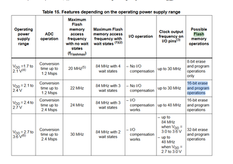

some flash operation depends on the MCU supply voltage (see picture).
I would like to program an STM32F401 with openOCD, where the MCU is supplied with 2.5V.
Is the possible?

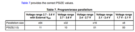

Yes, it is possible to program the STM32F401 with openOCD with MCU power supply at 2v5.
According to Table 7 of RM0368 we need to configure PSIZE with 01 (16-bit) or 00(8-bit).
PSIZE is not configured in the "stm32f4x.cfg" but configured rather in the "loader file" plugin located in ~\STM32CubeIDE\plugins\
The loader is in executable format, so not possible to customize it. I asked the development team what is the default configuration of openOCD loader for the STM32F401 in terms of PSIZE and flash clock frequency access ?
Hope it is 8-bit/20Mhz so that it is functional in all cases, otherwise a customized loader version will be requested to give guidelines how to change the openOCD project in the github.
