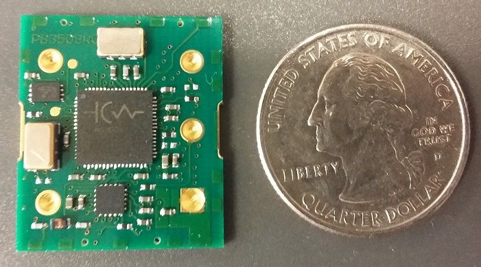

2020-04-02 12:15 PM
You'll also need a GND pin, and VDD if you plan on using a standalone ST-LINK/V2
Using the NUCLEO's ST-LINK is a bit crude for production work, consider using more standardized headers if possible (space permitting, etc)
For new designs, consider the 10-pin ARM SWD connector.
Using the STM32L011 here for it's small size, but the 16KB FLASH is pretty tight for things that came from a L073
2020-04-02 12:29 PM
