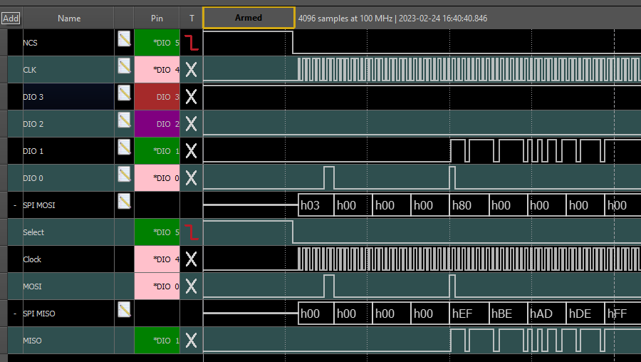

But in this mode, I'm able to erase, write, and read the flash via raw commands. But the memory mapped region just returns "garbage". I mean, it's close?
> stmqspi cmd 1 4 0x03 0 0 0
spi: 03 00 00 00 -> ef be ad de
> mrw 0x90000000
0xefddeafb
> mrw 0x90000004
0xffffffff
>Even more confusing, the signals coming back from the memory mapped operation look completely fine:
Am I missing something obvious? Do I need to explicitly disable cache? I'm just really lost here.

For Quad mode you'd need to free up the pins via QE bit in SR2
The Dummy Cycles DCYC=4 is causing the shift in the Memory Mapped data, READ (0x03) has no dummy cycles
