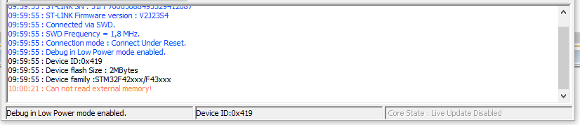

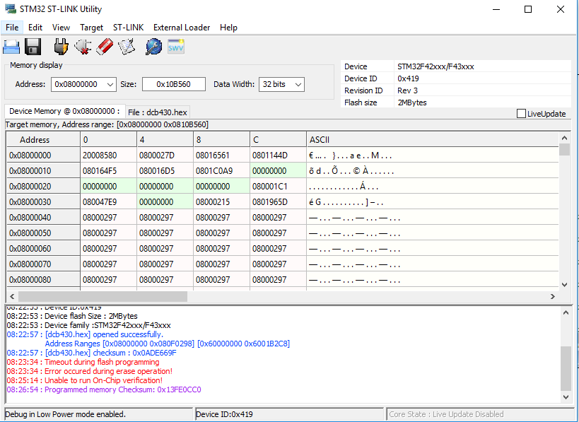

I'm trying to load a .hex file which KEIL I know that it works (because, through keil environment I don't have any problem), but during ST-LINK Utility programming I have the follow result:
There are Timeout during flash programming, erase operation errors and ''unabla to run On-chip verification'' but, finally appears ''Programmed memory Checksum: 0x13FE0CC0''. So, what is meaning this result?
Why I have these errors? Do you know how I can solved it?

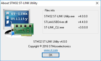

Could you please specify the used STLink utility version. I'm not able to reproduce the issue using version 4.0.0.

The version is 4.0.0.0 too.

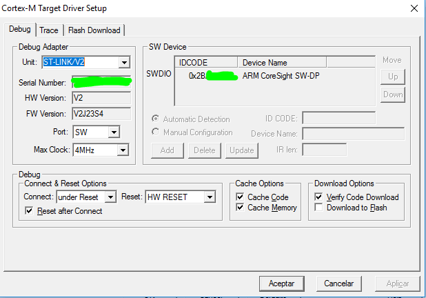

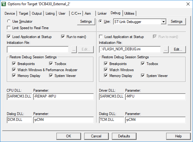

1.- Debugger in KEIL is ST-Link Debugger as you can see:
