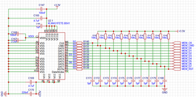

I've just received my custom PCB with an STM32H743VIT6 MCU.
It has a Samsung eMMC connected to the SDMMC1 interface (MMC 8 Bits Wide Bus) :
(I'll link the eMMC datasheet below.)

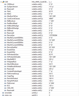

Here's the variables states at this breakpoint :
The data does not seem coherent. Am I missing something here ?

2025-01-17 8:00 PM
Just questions and thoughts:
- why do you have 5pF caps there?
- why do you have everywhere pull-ups? (really needed?)
- are you sure to have an external eMMC chip for 3V3 logic levels?
(there are different versions, for different "interface power")

2025-01-18 3:20 AM - edited 2025-01-18 3:21 AM
@tjaekel wrote:Just questions and thoughts:

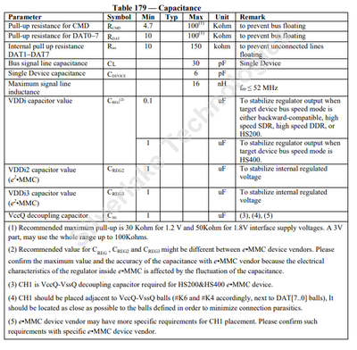

As per JEDEC standard, i applied what I learned from the standard no.JESD84-B50 :
So yes, pull-ups are indeed needed, and capacitors also.
For this eMMC model, i can totally power it with only 3.3V on both VCC and VCCQ :
The only thing is that, as per JEDEC standard, HS200 and HS400 will not be supported.

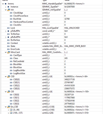

Here's the result on the variables state :
(Seems correct to me, as it corresponds to the 128-bit CID register)

Here's the result :
RCA seems valid, as it requires to be greater than 1, as per MMC protocol.

I get this result :
I don't know how to decode this thing, but it does not seem too bad.

I get this result :
And seems also good to me.

On the HAL_MMC_GetCardCSD, :
