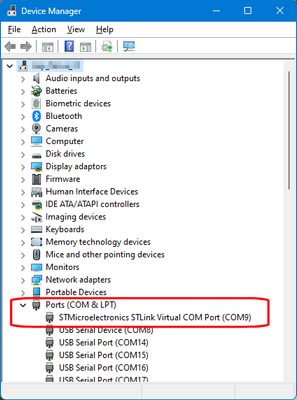

Is the ST-Link being detected by the host computer?
eg, does the Virtual COM Port appear in the Device Manager?
If the host computer isn't detecting the ST-Link, then there's no way that any other app (eg, debugger or programmer) is going to be able to use it.
