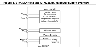

On the L4+ the VDDIO2 on GPIOG bank must be explicitly enabled
/* VddIO2 must be enabled to access GPIO port G[2:15] */
__HAL_RCC_PWR_CLK_ENABLE();
HAL_PWREx_EnableVddIO2();
__HAL_RCC_GPIOG_CLK_ENABLE();Is the configuration causing the MCU to RESET? Scope the NRESET/NRST pin, review other connectivity on a board level.

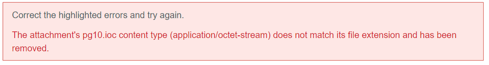

2023-11-16 8:19 AM
Hi David,
Thank you for your reply. I'd love to send my .ioc file. But the site refuses to accept it.
Has anyone a solution?

Thank you Tesla,
I'm sorry, but i cannot find how to enable the VCCIO on GPIOG bank. Could not find it in any manual. So a hint would be apreciated.

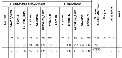

2023-11-16 9:15 AM - edited 2023-11-16 9:19 AM
from p. 24/307 -> DS12023 Rev 5
did you connect vddio2 -> vdd
