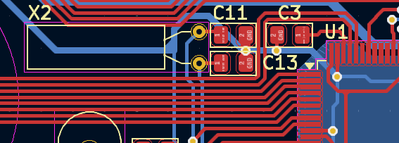

the RTC crystal is very sensitive to any stray in from surrounding signals.
So screen it as good as possible , if metal case solder ground wire there, and avoid any switching on adjacent pins,
as this might disturb the 32k clock.
And set crystal drive level high (if this chip has select for drive on rtc crystal.)

There is no switching near the RTC crystal pins, and it is mounted very close to the microcontroller. Even with the signals near the crystal turned off, the RTC still shows a delay. But why would it work with test code and not with application code?

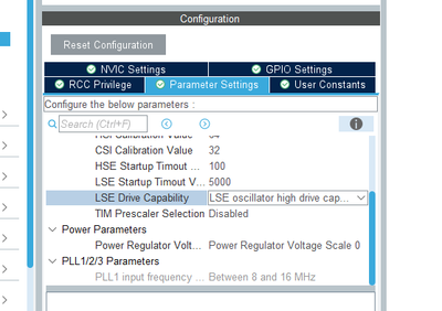

I tried using LSE High Drive, but the problems persist.
