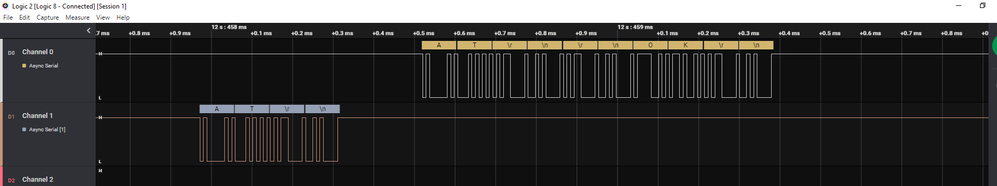

since some days I try to get a communication between a STM32F030R8 Nucleo and an ESP8266 WIFI module working. Communication between Putty and WIFI module works already. I am stucking at receiving the answers from ESP module. I already tryed it with interrupt or DMA and now simply with polling, but I can not read the answers from the module. I looked at the communication with my logic analyzer and saw, that the module seems to receive the AT command correctly and gives a correct response. All with the baudrate of 115200 wich I set for the interface.
But all I receive, also with simple polling, is a "r", nothing else.

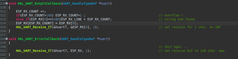

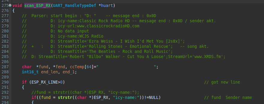

i needed ESP communication also; problem was: never know, length of string sended.
so i use the callbacks, on received char INT is started and i store new char to an array.
when line end coming, i set a signal -> global var to length of string.
then analyze string in main, IF var > 0 .
not so difficult...but need bigger array, because debug messages can be long...
and dont forget to handle error on receive !
start receiver action:
now always receiving...but need no cpu time, when nothing coming !
with error handling ... kick away.
parser:

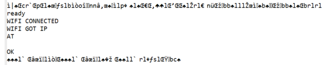

Thank you for the quick help. I've implemented the int with RxCpltCallback function again, this time with the overflow check like you did it.
#include "main.h"
#include <ESP8266.h>
UART_HandleTypeDef huart1;
UART_HandleTypeDef huart2;
uint8_t ESP8266_rxBuffer[200] = {0};
uint8_t ESP8266_rxCNT = 0;
uint8_t rxDone = 0;
static void MX_USART2_UART_Init(void);
static void MX_USART1_UART_Init(void);
int main(void)
uint8_t outBuf[200] = {0};
uint8_t i;
// MCU Configuration
HAL_Init();
SystemClock_Config();
MX_GPIO_Init();
MX_USART2_UART_Init();
MX_USART1_UART_Init();
HAL_UART_Transmit(&huart2, "\n\n\r", 3, 1000);
HAL_UART_Receive_IT(&huart1, ESP8266_rxBuffer, 1);
// Initialize ESP8266
init_ESP8266();
while (1)
if(rxDone) // Check if message was received completely
// Copy contents of receive buffer to output buffer without first char because its always the newest received
for(i = 0; i < 200; i++)
outBuf[i] = ESP8266_rxBuffer[i + 1];
HAL_UART_Transmit(&huart2, outBuf, sizeof(outBuf), 1000);
rxDone = 0;
void HAL_UART_RxCpltCallback(UART_HandleTypeDef *huart)
ESP8266_rxCNT++;
if(ESP8266_rxCNT > 198) // Catch overflow
ESP8266_rxCNT = 1;
else if(ESP8266_rxBuffer[0] == 0x0D) // CR detected
rxDone = 1;
ESP8266_rxBuffer[ESP8266_rxCNT] = ESP8266_rxBuffer[0];
}Now I can see some answers of the ESP module like in console, but the answer for AT command is still random chars
2022-11-02 12:51 PM
I just saw, that the whole output of the screenshot is dropped when the AT command is transmitted. In logic analyzer I can see, that the other outputs like "ready" or "WIFI GOT IP" are already received much earlier. But the output to console is only when AT command is transmitted

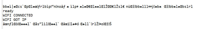

Made some changes in main:
#include "main.h"
uint8_t ESP8266_rxBuffer[1] = {0};
uint8_t recBuf[200];
uint8_t rxDone = 0;
int main(void)
HAL_Init();
MX_GPIO_Init();
init_ESP8266();
while (1)
HAL_UART_Transmit(&huart2, recBuf, sizeof(recBuf), 1000);
rxDone = 0;
ESP8266_rxCNT++;
ESP8266_rxCNT = 1;
else if(ESP8266_rxBuffer[0] == 0x0A) // LF detected
rxDone = 1;
recBuf[ESP8266_rxCNT - 1] = ESP8266_rxBuffer[0];
}Now output looks like
At least OK is comming through now, but still some random symbols after it
