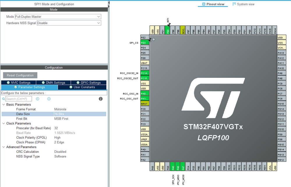

Here is my code and configuration in CubeMX.
