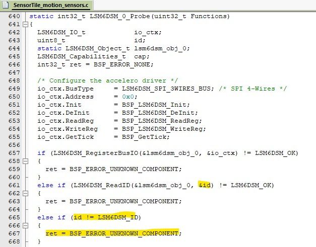

When I am debugging the controller via SWD and the ST-LINK (as recommended on the HP), the LSM6DSM and LSM303AGR sensors aren't initialized properly. The initialisation fails at the "LSM6DSM_0_Probe" (respectively "LSM303AGR_0_Probe") function with BSP_ERROR_UNKNOWN_COMPONENT because the ID isn't right (see picture). Can somebody help me here? When I start the board without debugging, everything works fine and I am able to get sensor values. Anyway it's super hard to insert new functions without the possibility to debug properly. Is it possible that there is a problem with pin sharing of the SPI when debugging and connecting to the sensors?
