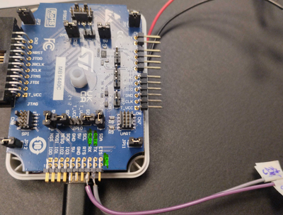

For CANBUS transceiver, pins with number 8 & 9 of CN9 of STLINK-V3 should be used. Additionally, there is no need to provide CAN_VCC on CN5 and JP7 of STLINK-V3 should be left open. The CN5 of STLINK-V3 is not compatible with a CAN transceiver completely. The T_CAN_RX pin of CN5 may be overloads the CANBUS but I am not sure.
2025-01-23 3:01 AM

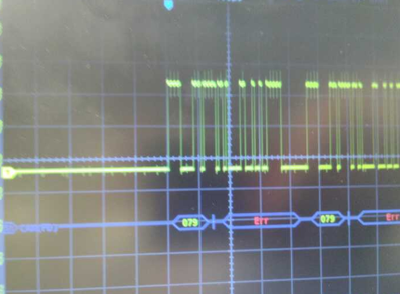

Im using CN9 C_TX and C_RX pins
Taking the 3v3 and Gnd from the reserved pins from the STLINK
Sniffing the CANH-CANL bus with an osciloscope i see a lot of errors, and my target Systembootloader board doesnt like it and enters SystemReset
